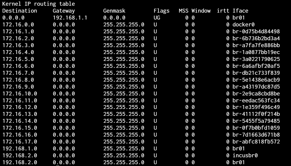

Here’s my netstat -rn:
In short, what I’d like to do is point the alias br01 192.168.2.13 to the gateway 192.168.2.1.

I do believe I got you just fine. I’m not very familiar with static routes, but you don’t need those to reach your second subnet. Just assign an IP (from the desired subnet) on the second truenas NIC (do not forget to remove an IP from the container).
Aiui sending network packets (to the particular IP) from the machine connected to multiple subnets works like this:
  1. If the destination IP is within one of these subnets, the packet will be sent via NIC with this very subnet.
  2. If the destination IP is not within any of the subnets, the packet will be sent via NIC with the default gateway. This default gateway is a router that will… route this packet to the next subnet and so on. If there is no default gateway, the packet won’t be sent.
So in your case with the truenas machine connected to two subnets (192.168.1.0/24 and 192.168.2.0/24) via two NICs (each NIC has an IP set from the particular subnet), you don’t need any static routes to reach any IP of these subnets. Moreover, you don’t even have to specify a default gateway (your internet won’t work, though). Thus, your containers also will be able to reach any of these subnets (at least if you didn’t change the network mode). Just tested it (not with truenas).
