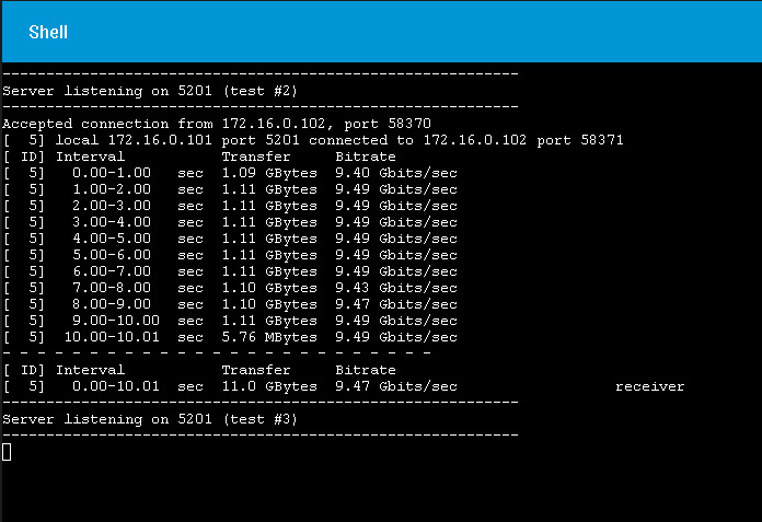

This is what I got with two computers connected over 10Gbps with fiber. This is default network settings. No messing with Jumbo frames, etc.
