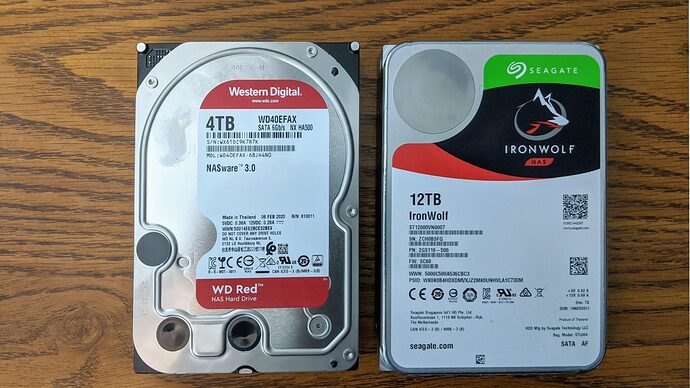

You are using Seagate SMR (shingled magnetic recording) drives in your system. These types of disks are not recommended for ZFS and can result in exactly the type of error you are reporting, unfortunately.
This article does a pretty good job explaining
At absolute best, SMR disks underperform significantly in comparison to CMR disks; at their worst, they can fall flat on their face so badly that they may be mistakenly detected as failed hardware.
