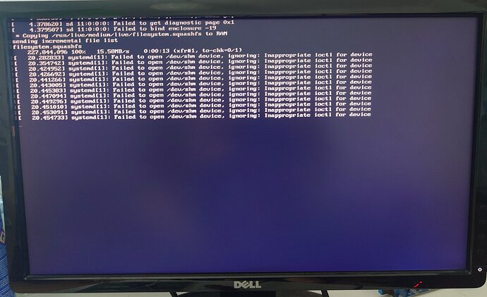

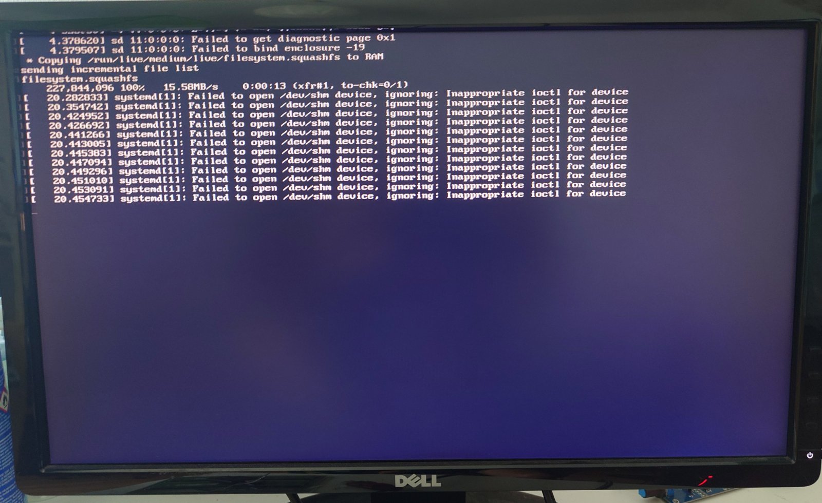

I’m new to this Nas thing and I am trying to install TrueNAS Scale on an old pc but it keeps crashing and throwing errors at me.
Also tried to install OMV but same thing.

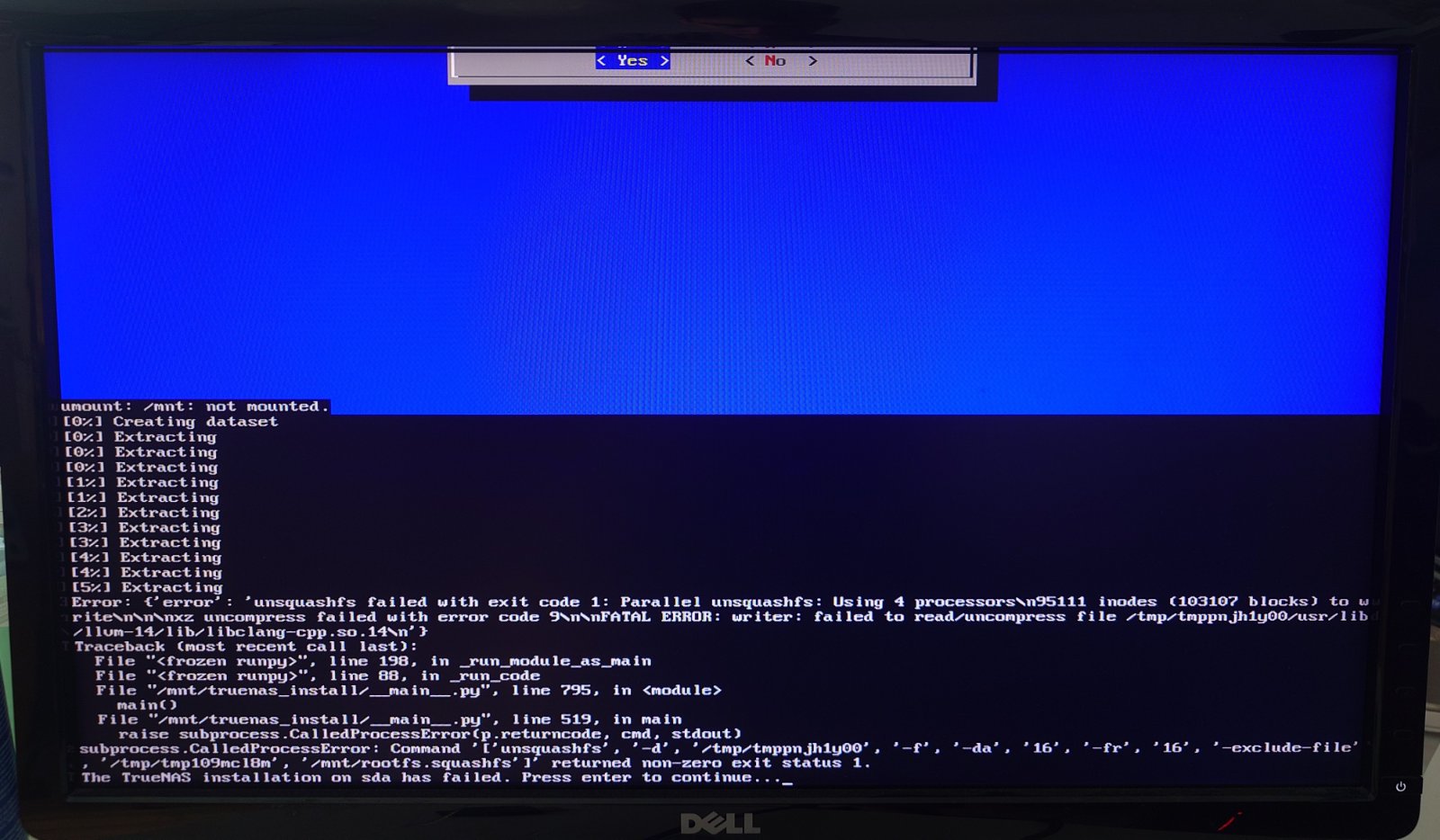

Tried to install it again with a fresh iso but it seems that it has other problems.
It also crashes when Extracting [8%] then it says kernel panic or something like that.
