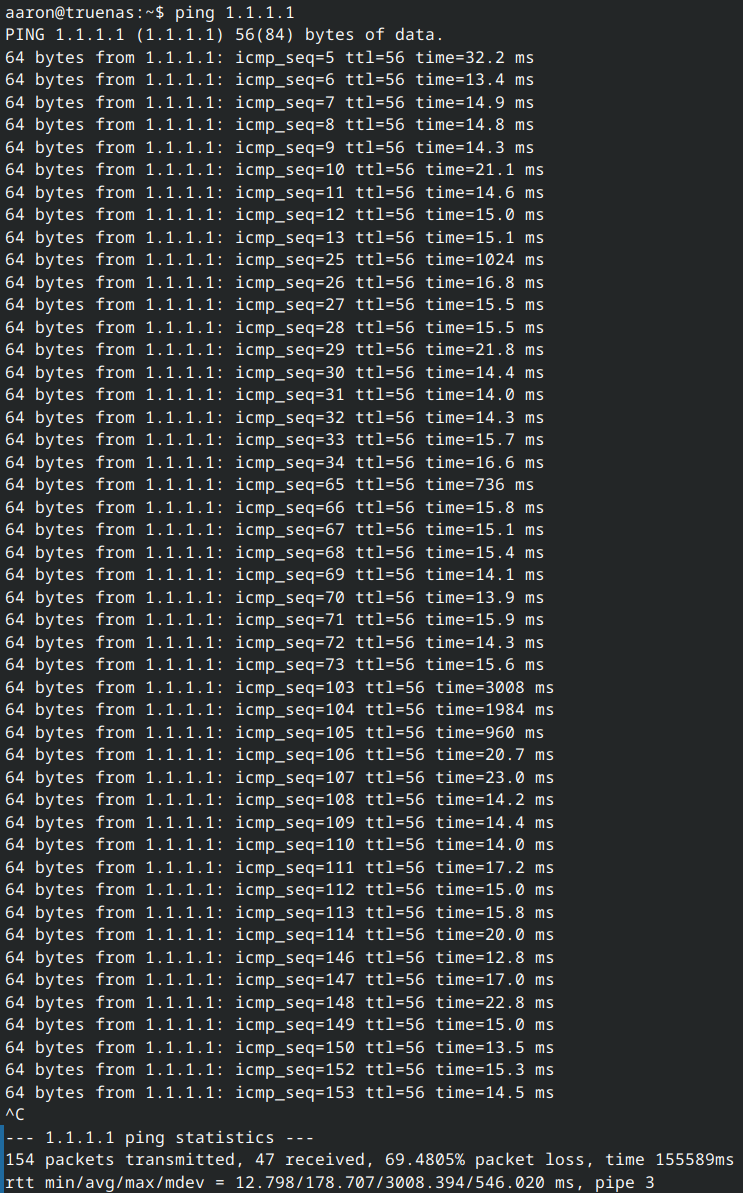

From the command line, I initiate a ping to either 1.1.1.1 or 8.8.8.8. After 5+ minutes, I get anywhere from 50 to 80% packet loss. This occurs even after a reboot of the server.

Note that when the outgoing packets are being lost, I can ping the server from another PC on the LAN successfully 100% of the time. I can also ping a LAN PC from the server 100% of the time. It’s only outgoing packets to the internet that are intermittently getting lost.

Attached is a sample ping output to the internet.
