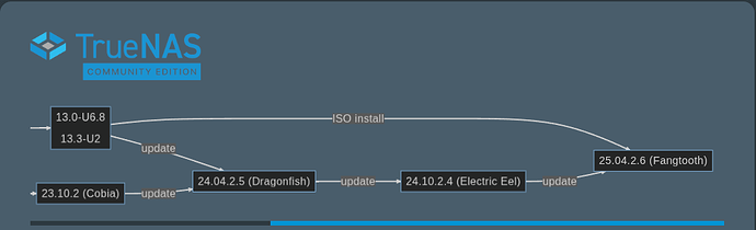

You can do both, but updating from the gui has to be done in a certain order.
Thank you for that guide. That’s helpful. Is there any real reason to opt for one or the other? The only addition I plan to make at a certain point is to add a graphics card to this machine and it currently doesn’t have one. I’m hoping that’s more or less plug and play, but not expecting it to be.
