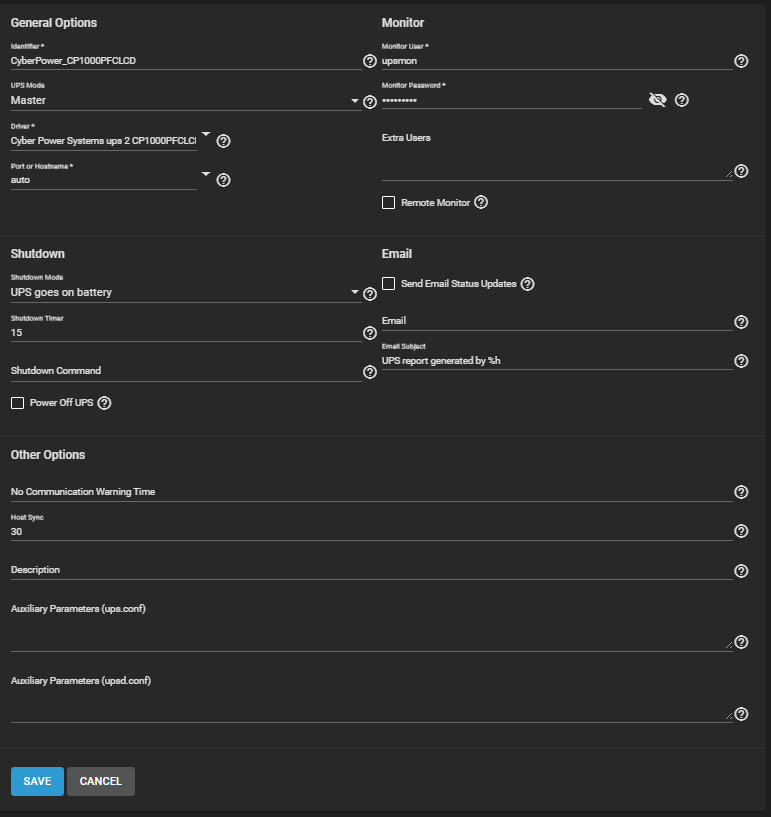

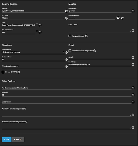

Hi. I am using a CyperPower CP1000PFCLCD UPS on TrueNAS Core 13.0-U6.4. When the UPS goes to battery, the server begins shutting down after ~30 seconds, even though I’ve configured it to shut down after 15 minutes.
Below are screenshots of my config and the output of
‘upsc CyberPower_CP1000PFCLCD’:
Any help would be appreciated, thanks!
You have the shutdown timer in the Truenas ups setup set to 15 seconds. 15 minutes would be 900 seconds. give that a try.

Silly me, I didn’t read the tool-tip carefully. It’s working now, thank!
