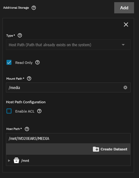

Did you add a media folder in the App config as additional storage?

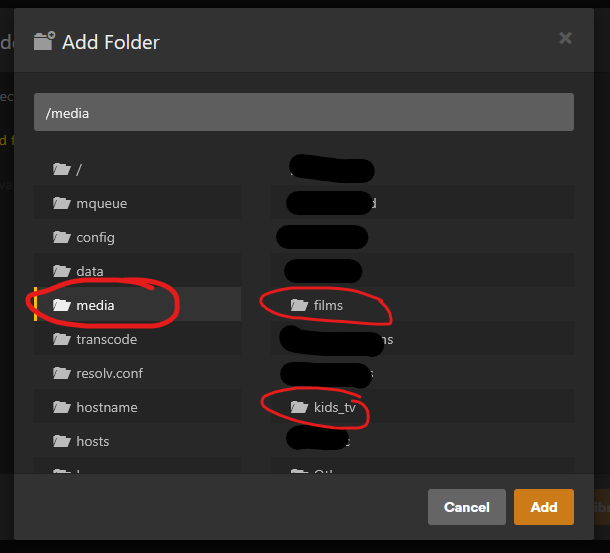

Then in Plex you have added a Library pointing to a folder within that media?
