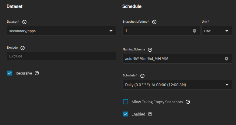

To give context, the dataset Im trying to take snapshots of hourly, is a sub-dataset of dataset apps, let’s call it mc-server. I’ve also got a daily snapshot task that takes snaphots of all the datasets inside apps. Here’s the config for the task.

Originaly I had only Run Automatically ticked, which ment that the task would start
immediately after the linked periodic snapshot task completes
as the tooltip states. This made me think that, for some reason, the task would get triggered by the hourly snapshot task. That theory was wrong, because when I also ticked the Schedule option, the periodic snapshot task still spun the drives up.
Then I thought, maybe its because this snapshot task doesn’t have a linked replication task, which as far as I know shouldn’t make much of a difference, but I figured it could be worth the try. I setup a linked replication task that was set to run daily, and wouldn’t you know it, absolutly no change whatsoever.
I also set the hourly snapshot task to not allow taking empty snapshots, and the drives spun-up despite the fact that there where no shapshots taken, which further proves my point of something waking the drives up, just because there’s a snapshot task running.
