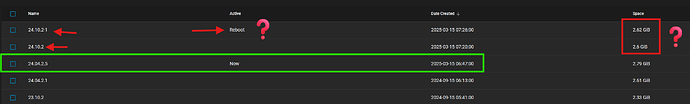

I checked the boot environments in the UI and found the following.
There are two boot environments for ElectricEel with differing file sizes. It seems the first did not successfully complete?

Image attached.
