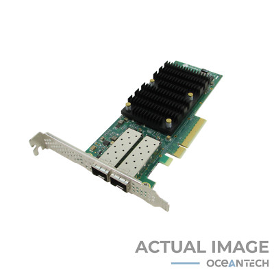

Chelsio has always worked well with TrueNAS. I’ve used the T520 for at least 10 years across multiple systems and it’s never missed a beat.

This, Chelsio works, always get max performance, and you can even get the 10/25Gb 6000 series models used for like $40 US on ebay lately
