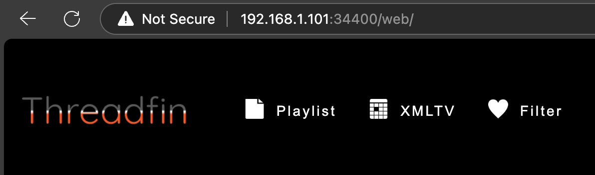

Did you try accessing the webui with http://[truenas ip]:34400/web/ ?
no whork… ![]()

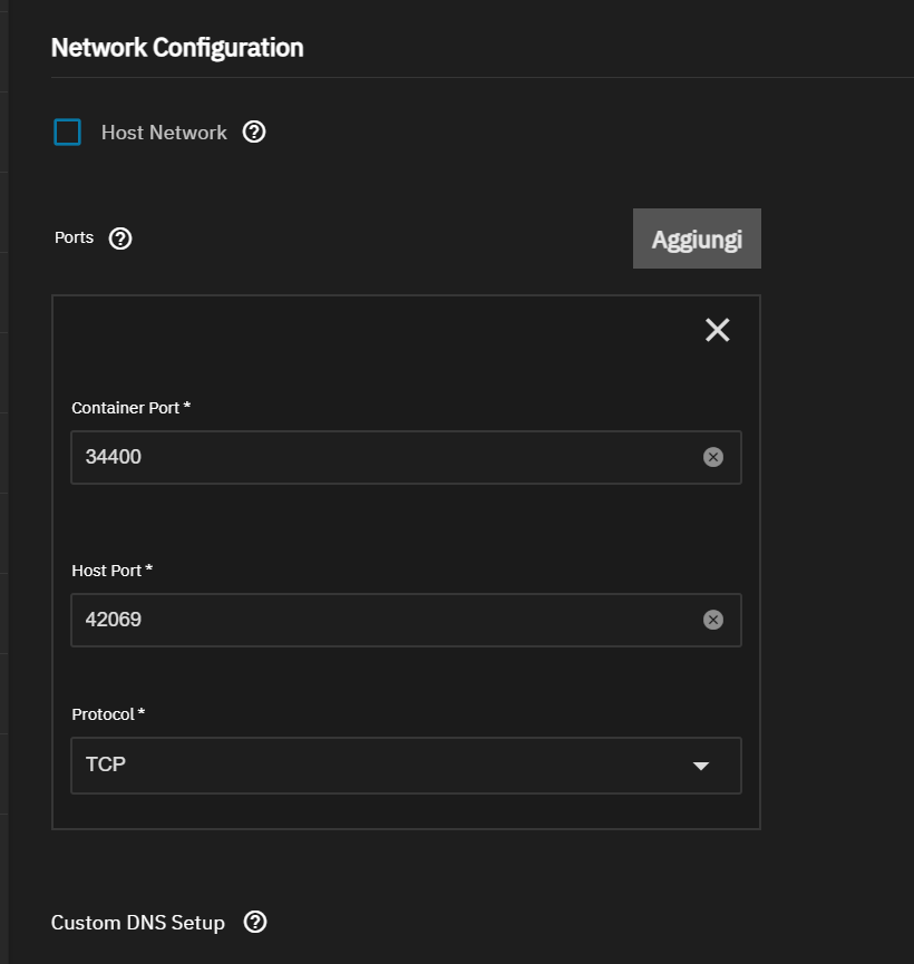

Yes, since they are on the same host they cannot have the same port.
Leave the container port 34400 and change the host port to something else.
try to change port ?? ex 35400 ?
Leave container port 34400 since that’s what the process is using. Change the host port to whatever you desire. Elon would choose 42069
lol I was being childish about the port but yeah. Try that…
sorry… no Work ![]()

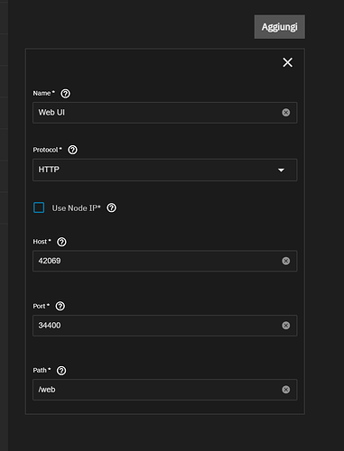

I guess you have already noticed, but in the portal config screenshot, “Host” should be the host IP (not a port), or you can just Use Node IP.
ok, tomorrow try to change it
TNX ![]()
