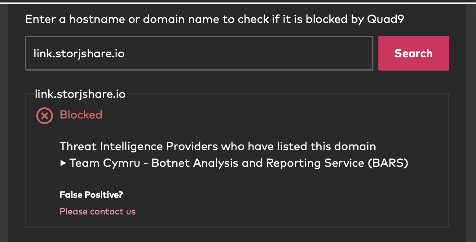

I’ve just done a little investigating and found that the host/domain link.storjshare.iois still blocked (unfortunately I cannot post screenshots here), but you can check it by yourself here: https://quad9.net/de/result/
The domain is still blocked due to the following concerns:
  • Team Cymru - Botnet Analysis and Reporting Service (BARS)
It’s just for your information.
Just a little remark, Team Cymru is american :wink:

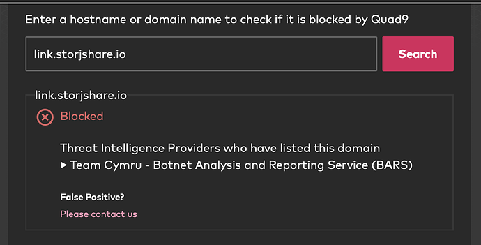

Confirmed blocked by Quad9
Submitted an unblock request to Quad9.

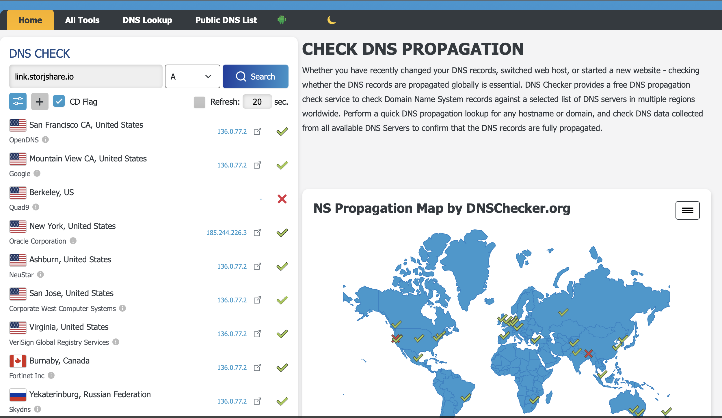

Looks like link.storjshare.io is at least resolving now, but it is still blocked by Quad9. I have not received a response yet from Quad9. I temporarily added Google DNS in the meantime.

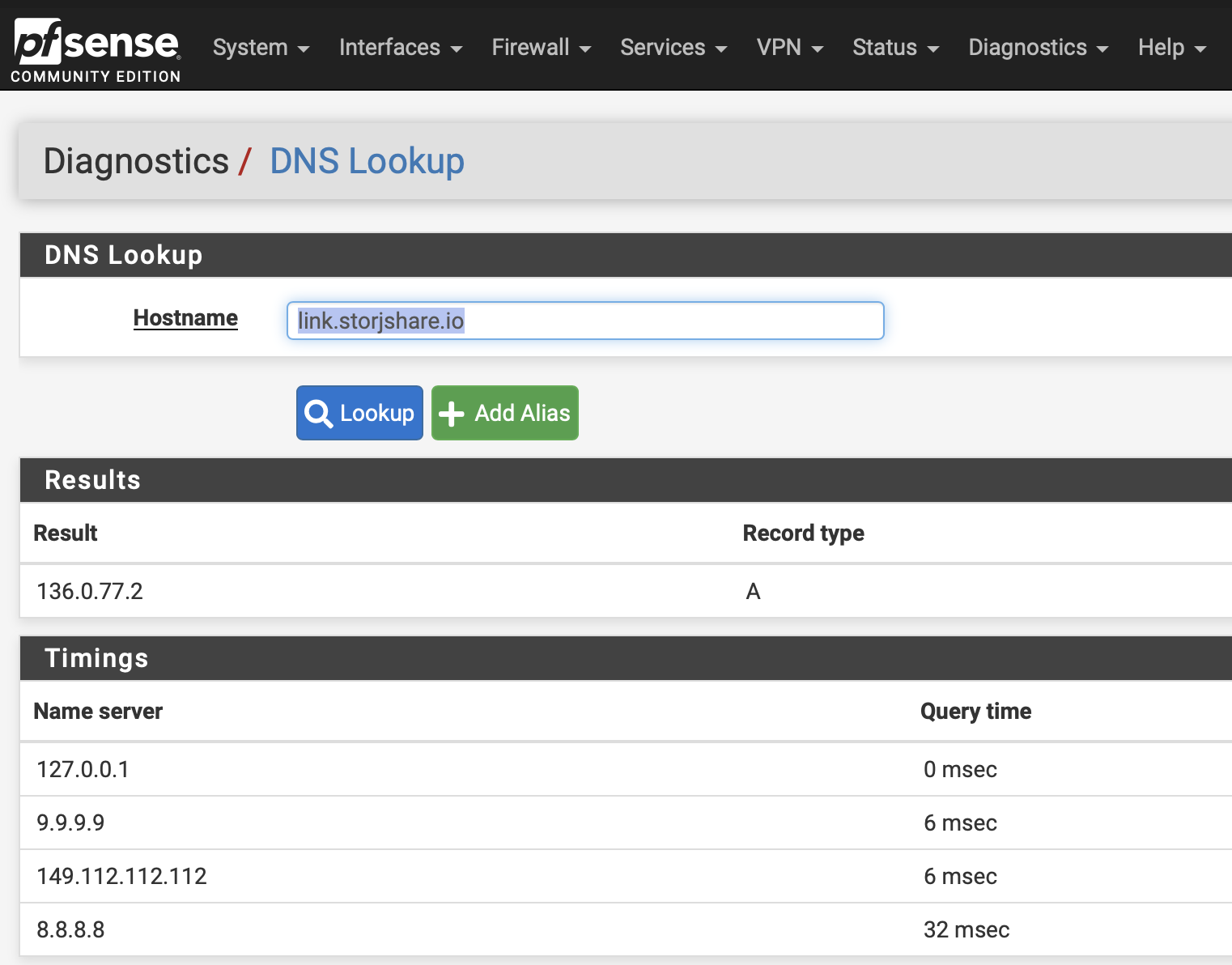

I appear to be having an issue.
Doing checks from TrueNAS Scale shell, everything says it should work, but the Check for Updates fails.

I can reach the URLs fine.
I have my TrueNAS IP bypassing all blocks on my pfsense firewall (wide open all any out, removed from pfblockerNG rules), and it has the same rules as my primary system I use even when not bypassed and on my primary system I can browse to https://update.ixsystems.com/ fine and it lists contents.

Thoughts?
What am I missing or doing wrong..

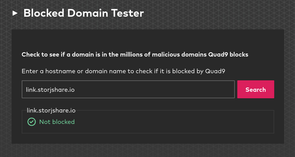

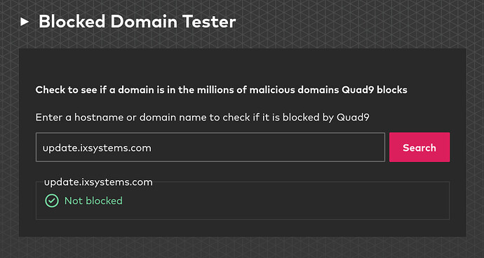

Quad9 is my primary DNS but checking the site it shows not blocked.
