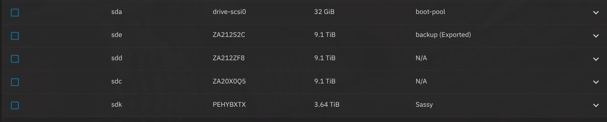

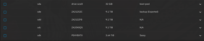

All three disk are listed when I look at ‘Disks’. The first one shows ‘backup (Exported)’, the other two show ‘N/A’.

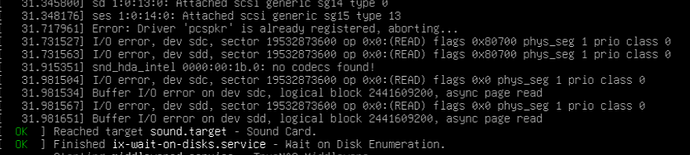

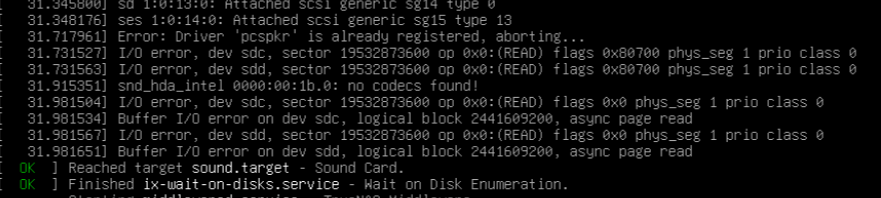

Just watched the VM boot and noticed these error messages:
sdc and sdd are the disks in question. Don’t know if this helps.

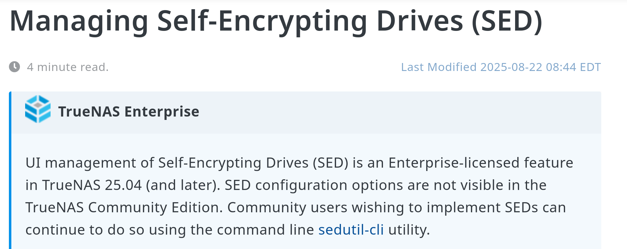

Edit: Looks like I need to use openSeaChest_Security to unlock it. I’m not sure what the password would be though. Will it be my admin account password or some sort of Seagate default password. I don’t remember choosing to encrypt the drives and the one drive doesn’t have security enabled at all so I feel like this was something that was triggered by the power failure.
Maybe you could try an older boot environment, but that might not work due to feature flags or try sedutil-cli.
