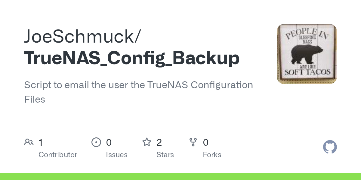

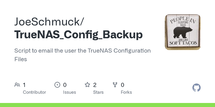

My Fangtooth config file is 33KB, Core is 50KB. These files are compressed (.tar) which is easily opened on any platform. They really shrink down the 810KB. Inside my file is 752KB which supports @LarsR comment.
Multi-Report by default will email you them every Monday.
If all you want is the config file, look at the link below:
This is all it will do in case you do not desire a full report and Multi-Report to manage your SMART testing.
