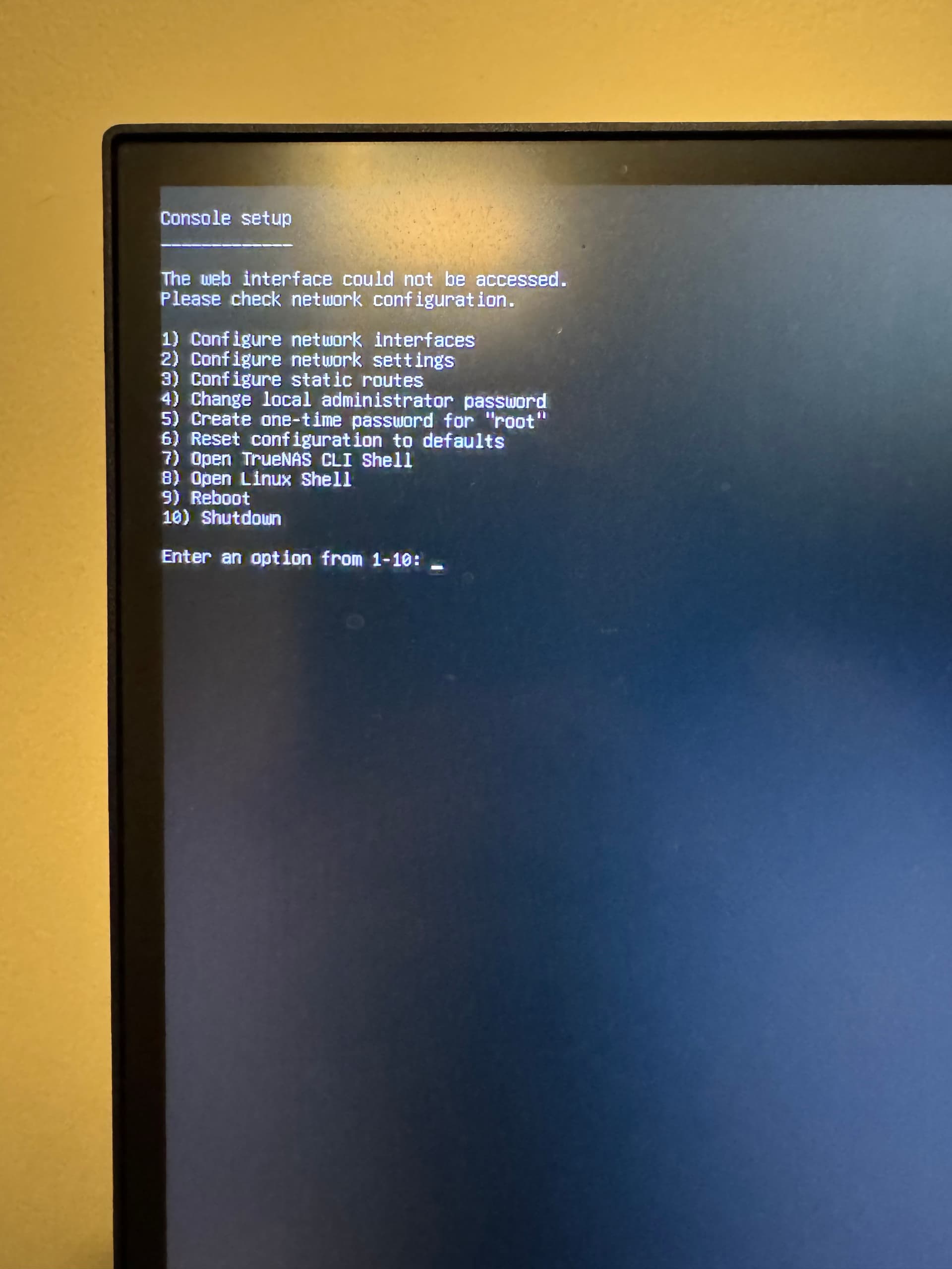

if as you said you can access SMB services on the NAS it has to be getting an IP address I would think. can you upload a screen shot of the NAS console screen with the exact error?
Sure this is what I’m seeing on the console.
Well, yes within the network config all of the DHCP is set to empty string but I have a bridge with an alias and have that ‘fixed’ in my router, that IP is getting pinged just fine. I am also able to use SMB and even my plex server, its just the web interface that does not seem to be loading.
Given what you describe to @dan above and the screenshot it sounds like the web interface is not “bound” to the static IP you configured. If memory serves TrueNAS will bind the first interface it sees and if you add static alias entries you need to go in and specifically add those to the list to accept traffic on for the web interface. I’m not sure how to check this from the console though. In the GUI it’s under System → General Settings → GUI.
