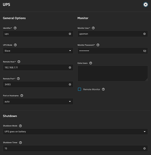

I have a similar problem.

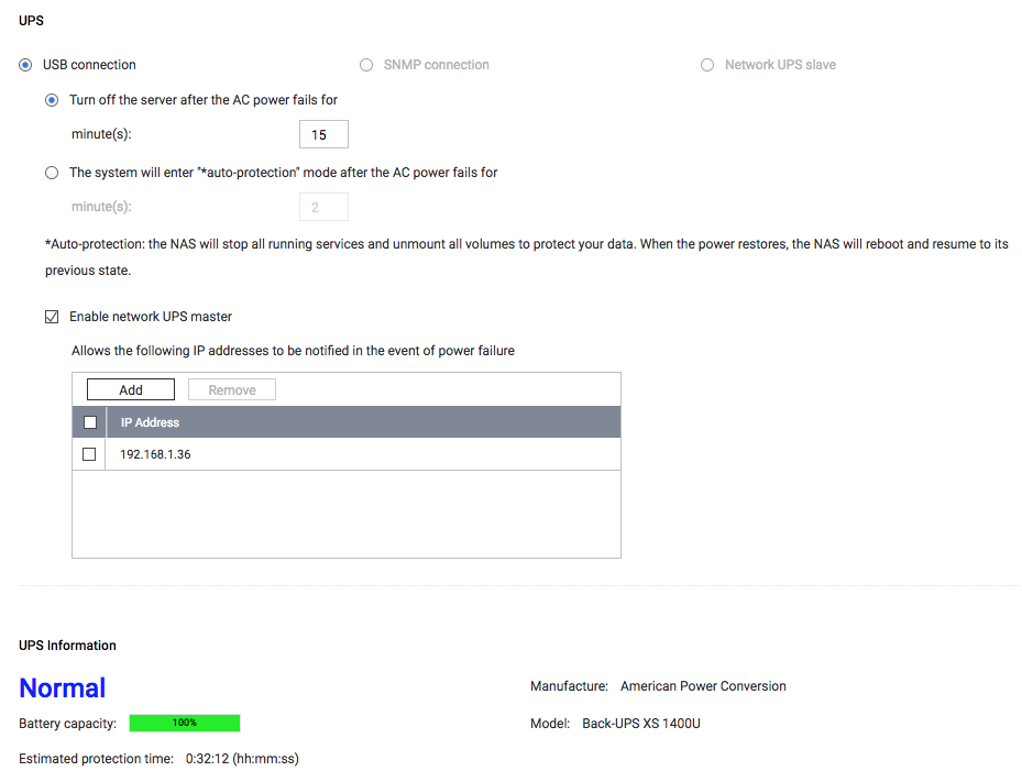

I have my UPS connected to a QNAP via USB. It’s a APC Back-UPS XS 1400U.
I enabled it using the setting you can see in the screenshot.
When trying to setup TrueNAS as slave.

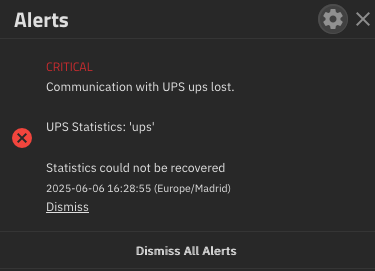

I’m getting the following errors:
Not sure what I’m doing wrong. Is there a way I can check the communication is working?
