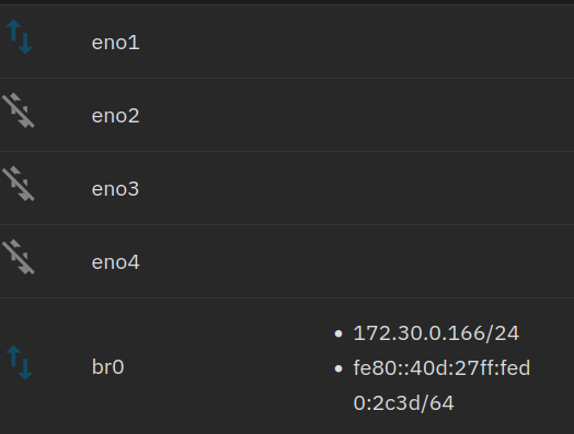

And you did move the host IP address configuration from the physical member interface to the bridge interface itself? AFAIK this is necessary for VMs to function across the same bridge.
In FreeBSD (TrueNAS CORE) it definitely was. If Linux bridges behave similarly, then …
Should be ok, right?

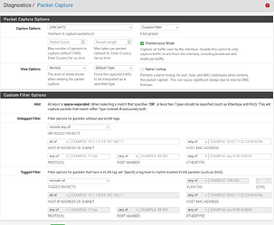

You can do a packet trace from the web UI, probably. You can in OPNsense, I’d be surprised if you could not in pfSense.

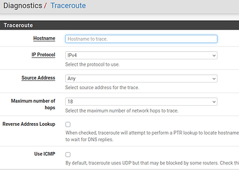

I do need some advice with packet trace: do you mean Traceroute:
… or Packet Capture:
Could you explain in more detail what exactly the background is and how I can configure this in my case?
