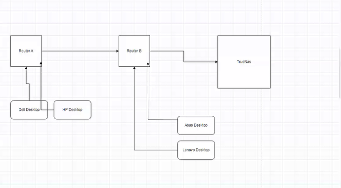

I have Router A and Router B, now Router A is feeding Router B with internet using WAN connection. And i have TrueNas connected on Router B using Lan cable and port. But my issue is Users on Router A is or are not able to access TrueNas on from Router B. I checked interface only shows on network configured that is Router B since its connected physcally to it.
I tried Connecting TrueNas to Router A rather than Router B and this time Router A sees TrueNas but Router B can not see TrueNas. I will be waiting for support if anyone here can help me achieve what i want.
I Want uses on Router A to be able to Access TrueNas from Router B ,as i m going to reconnect Truenas to Router B
Are these routers in the strict (old-fashioned) sense (i.e. they simply route between subnets) or are they Internet router/switch/firewall or plain old switches?

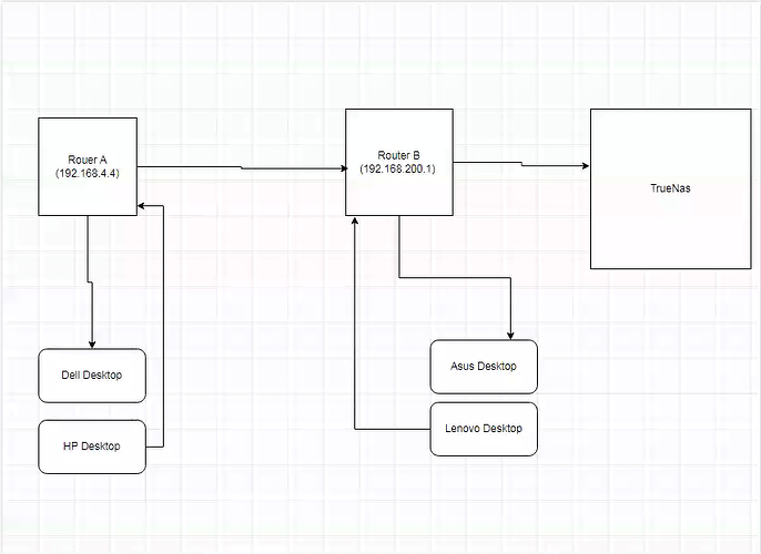

It would help if you could add the IP addressing scheme to your diagram.
Looking at the drawing they would be router/switch/firewall and the setup would be to have everything on come to one network subnet - RouterA. It’s why the instructions on some devices say do not use the ‘yellow’ WAN port if connecting a switch, another router device/ap, computer to the router/switch/firewall device as it won’t work or work properly.

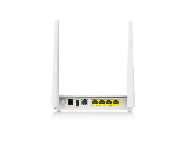

I have a Hauwei Gpon Echolife HG8145V5 as the router B which do not have internet but rather getting internet from Router A and Router A is a T-Mobile Router.
Hauwei Gpon is a fiber optic device but since fiber optic does not reach our company office we have Router A that is the T-Mobile Router to serve internet with Sim.
Router A IP address is 192.168.4.4
Router B has IP address of 192.168.200.1

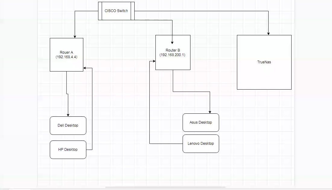

How ever after reading your amazing comments and responses incase my connection can not work due to Wan connection. If i serve a switch from router A then connect the Switch to Router B will i get truenas .
If there is a way to properly do this with my Wan connection i will wait for you guys if not i will need options from you guy once again. Router B can not have fiber optic now so the only way to connect to it was to configure it on WAN, i turned one lan port (Port 4) of Router B as a receiver .
I think this wont work either if i use switch because its just same as plugin of Truenas on Router A and Router B not seeing TrueNas.
