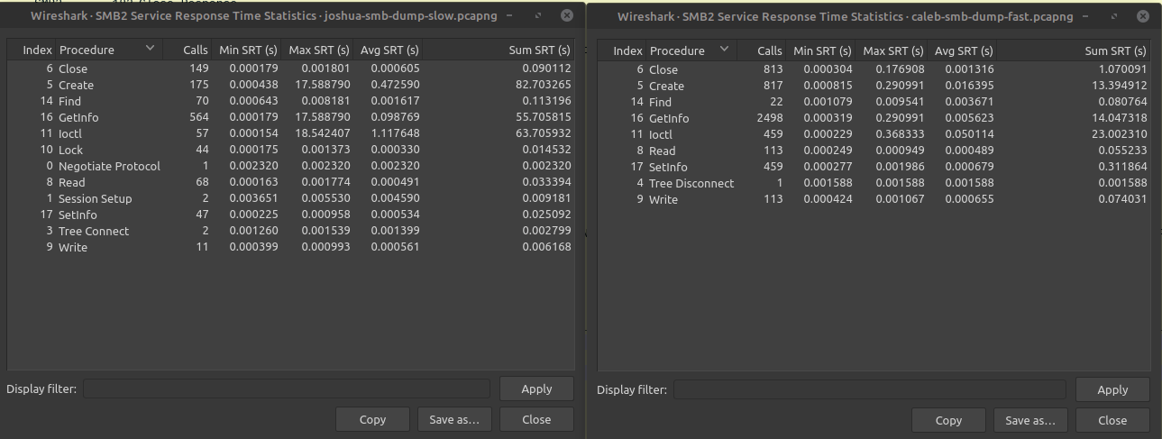

I did a wireshark dump of the slow server, and another fangtooth system that does not have this problem, copying the same directory each time.
After 65s, the slow system (Joshua) had captured 2,200 packets, while after 30 seconds, the fast system (Caleb) had captured over 10,000 packets.
I pulled up the Service Response Time Statistics view in wireshark, which might be instructive. Below is a screen shot of the two system next to each other (slow on the left, fast on the right):
You can see that the average response times for the “Create”, “GetInfo”, and “Ioctl” commands are all much higher on the slow system.
Let me know what else I should look for, or if it would be helpful to upload the captures here.
Thanks for the help!
