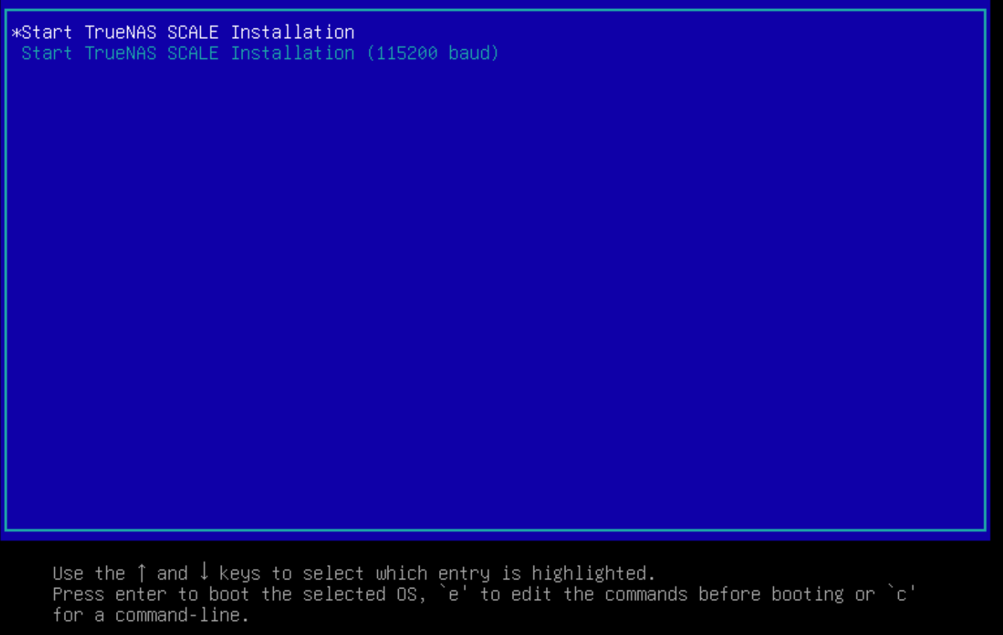

I think I have followed the instructions correct I boot from the usb stick and get this page
I choose the top option and then just get a black screen? Is this normal?

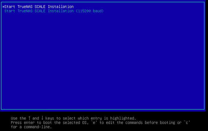

How long did you wait with the black screen showing?
10 mins or so
You may have to wait longer, its a large file. Two things to check, confirm your iso is correct by verifying the checksum of the copy of the USB, I’d try again and leave it for longer.
Right I have it up and running, it didn’t like the Mellanox 100gbe NIC I swapped it for another and it works fine recognising the NIC ![]()
