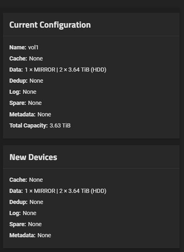

Yeah, what he has looks correct to me. He has an existing mirror and he is creating a new mirror and adding it into the pool. Everything else is empty.
Sometimes its easier to look at the right side to see the final product as well:
That did it thanks you everyone for the direction and help!!
I think I was getting confused by the options I was seeing available
