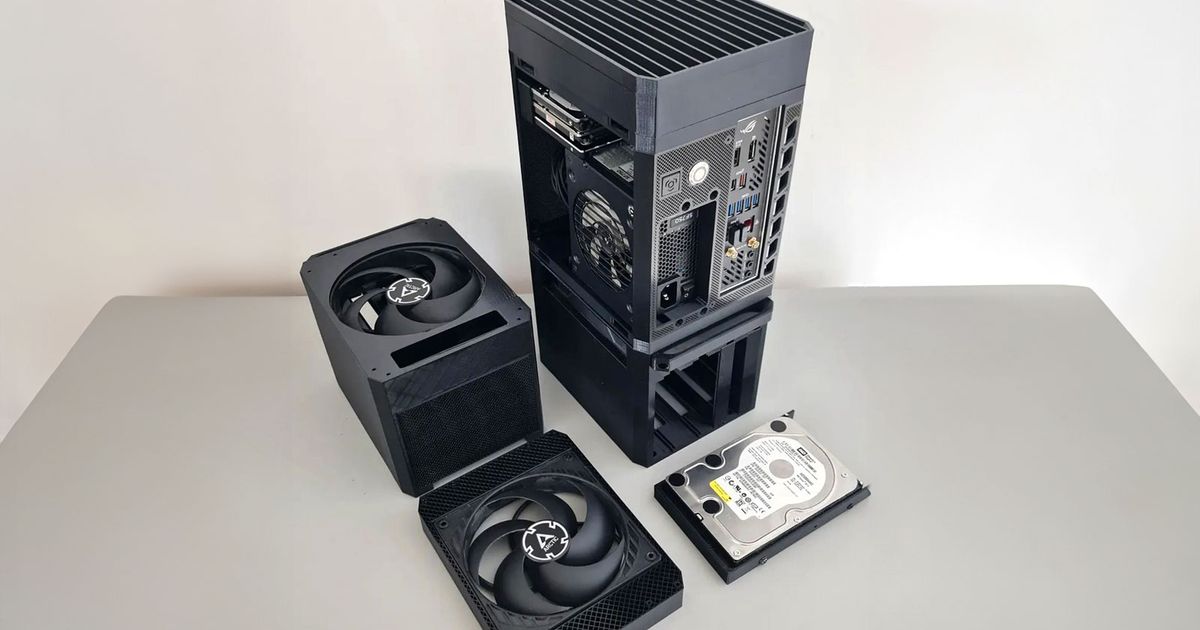

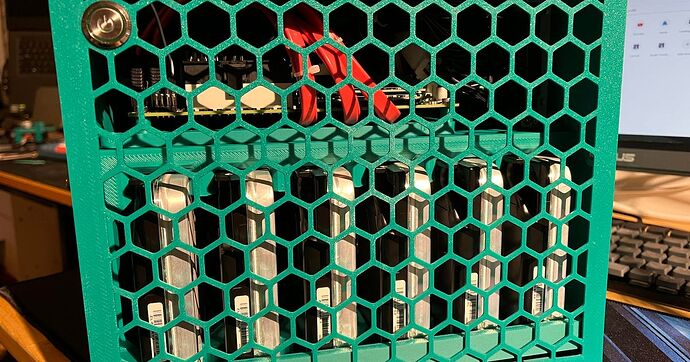

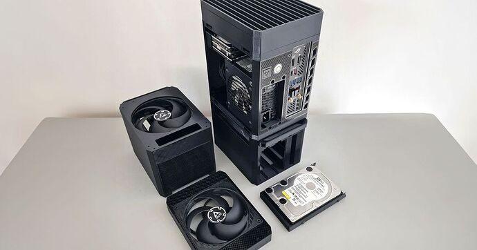

About US$250. A 32GB RDIMM, US$60. The 45HomeLab HL8:
https://store.45homelab.com/configure/hl8
Pricey, but 8 bays in the most compact chassis I’ve seen. For some less-pricey (and less-compact) options, see other comments in this thread:
Or you can 3D-print your own:
or:

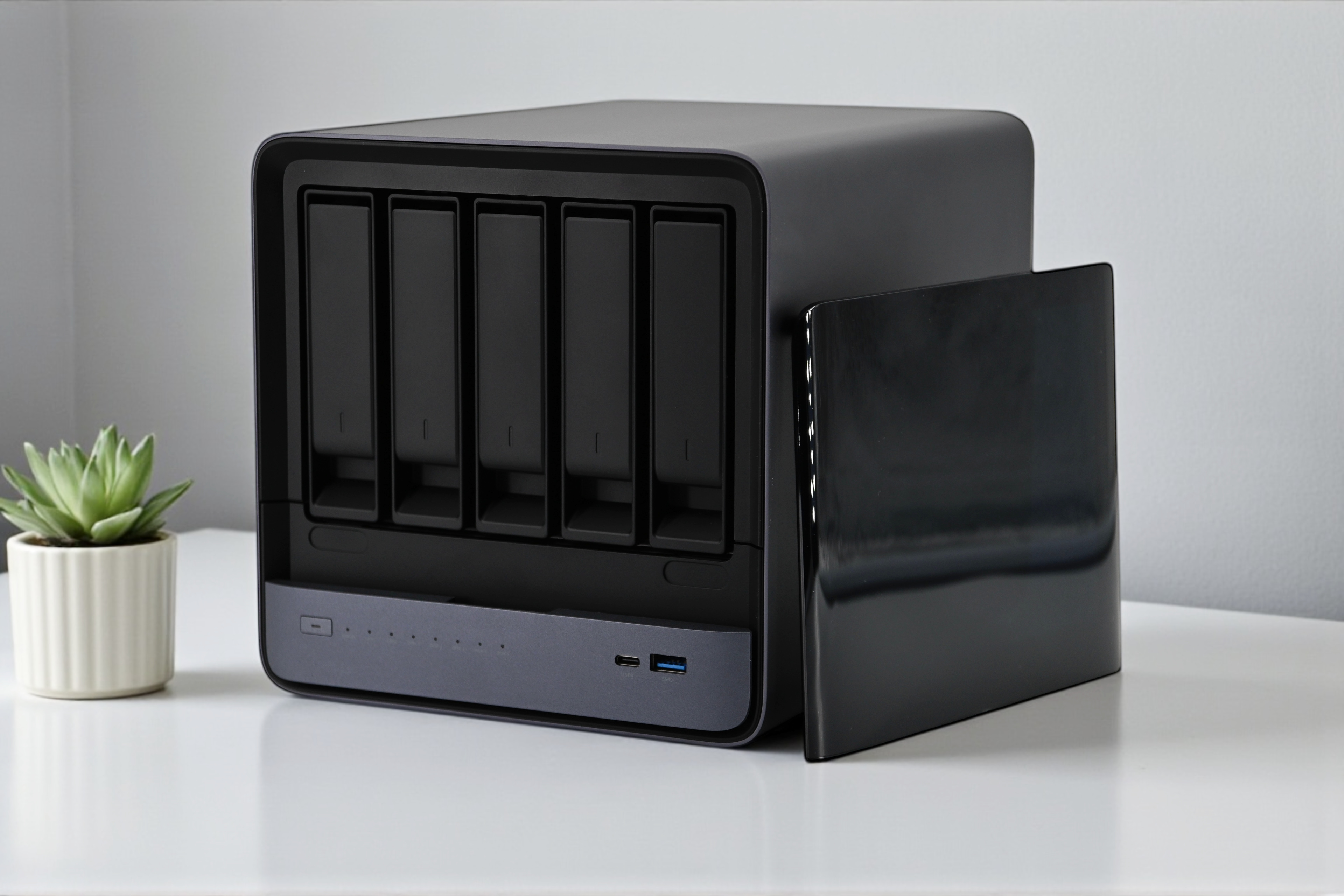

The new Miniforums NAS might be something, just 5 bay but nice specs.
There is also a non pro version without ECC-RAM for a lower price.
A X10SDV board in a Node 304 case fits this perfectly, including 10G.
If transcoding is required, throw in an Arc A310, possibly on a x8x4x4 riser so you still have two more M.2 slots for an app pool.
I would NOT trust a Jonsbo N case for cooling.
DDR5 ECC SO-DIMM does not match my own definition of “nice”… YMMV.
This. And now with the possibility of 4 U.2 drives.
