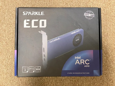

  1. Any brand? Any “better ones”? I don’t like fans, any without fans? Amazon top hit returns this one: Amazon.com: Sparkle Intel Arc A310 ECO, 4GB GDDR6, 50W TBP, Short Bracket is Included, Low-Profile, Single Fan, Single Slot, HDMI x1, Mini DisplayPort x2, SA310C-4G : Electronics
  2. Will it fit? Height-wise looks ok, but doesn’t look like it will fit lenght-wise… Is there history of people actually installing them into Mini-R?

I read quite a few posts about sparkle fans. They keep ramping up and down which could be a bit irritating. I do not have the card myself though.

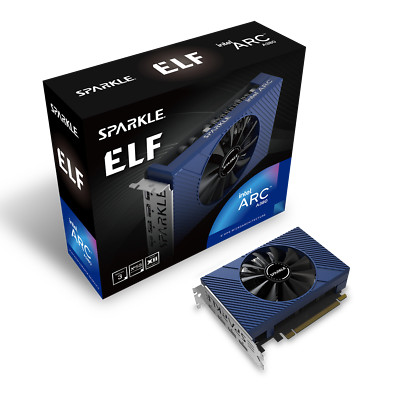

After reading more on this, looks like this one might work great, but again, fan issues? Will it fit?

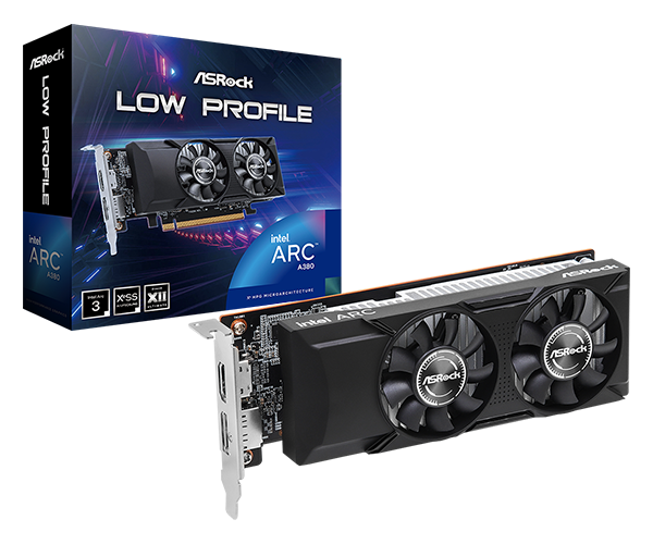

Or maybe even better this one?

The A380 ELF will not fit as it’s a full-height, double-width card. You’d have to rig up some manner of right-angle riser or flexible PCIe cable extension.
The ASRock low-profile A380 is a half-height double-width card and should fit:
That said the Intel A-series has the same media engine across the board.
Reading more on this. “ELF” is low profile but 100mm, from what I found, half-depth is really 69mm which this ASRock is.

The only other option is A310 ECO (cheaper) which also seem to be low profile and should work, but bad reputation?

The sparkle a310 eco has gone in and out of stock on amazon before, so if you’re interested it may just be better to wait and see.
My personal experience with that card is that the fan speed does fluctuate rapidly. Firmware updates do help somewhat but don’t completely solve the issue. If your nas is tucked away then of course the noise won’t matter much but for me it was a problem.
Some more information about the firmware is in this reddit thread: Sparkle A310 ECO Firmware Update Released
This one seem to be readily avail on ebay, from Japan, but looks like it won’t work for me as I need half-height. They have “ECO” version which should work, but I don’t really want those anymore. Noise IS a concern.
Looking at only 2 ASRock variants I found. One (380) on ebay and another (310) on NewEgg. Waiting for pro responses from @etorix and @HoneyBadger on specific sources if they know of any.
From what I read up to now, 380 will do couple extra simutaneous encodings. Not that it makes huge difference, but prices for what I found identical. Power use at idle seem to be only 2W difference in tests, so…
Apologies, I meant the Eco, and I sympathize with the noise concern. The asrocks are probably your best bets if you can find one. Last time I saw them in stock on Amazon was late March.

I don’t believe there should be any difference in compatibility between the A310 and A380, other than the potential of a couple extra encodes due to the extra 2GB of VRAM on the A380. The dual-slot A380 is likely to run quieter + cooler though because of the additional heatsink mass.
Ended up getting ASRock A310 new from Amazon seller. We will not have more than 1-2 transcodes, should work just fine.
