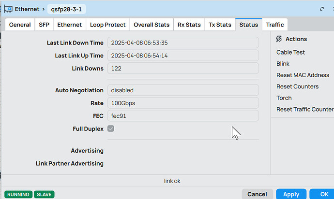

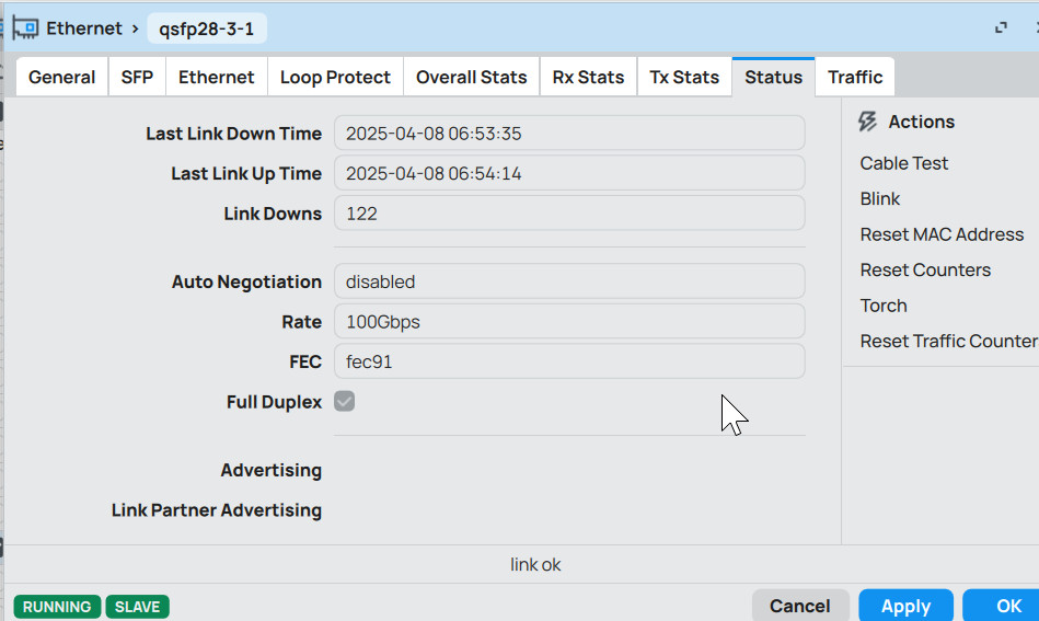

Auto nego is off, I use 100G, fec91 and full duplex

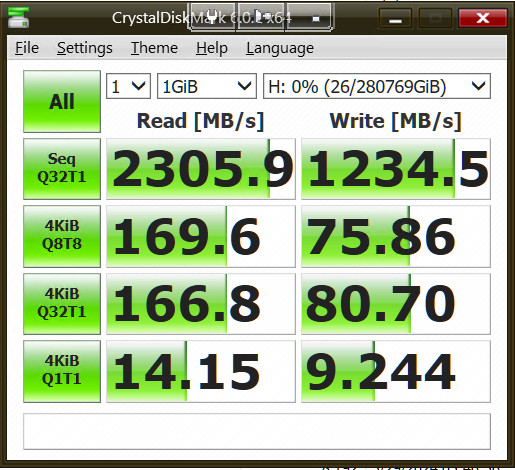

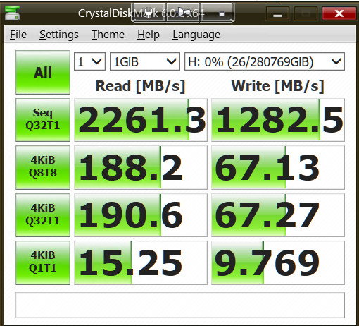

Here is Crystal results with 2x9 VDEVs, and no metadata SSD set:

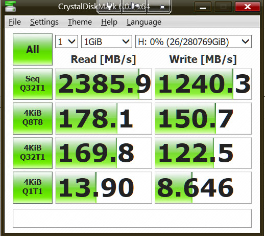

And here adding a metadata SSD:
That does not change much, I was mistaken thinking it did an improvement.
And here is a single 18x VDEV without metadata SSD:
With a single large VDEV apparently, 2 write values are quite better.

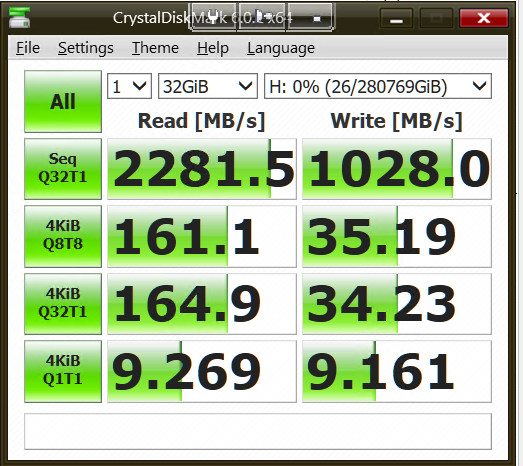

And a more realistic 32G test:
Still pretty good.
There is still a question: network can run at 2281 MB/s. Direct write test on the array gives 3500 MB/s. Why does write cap at 1000?

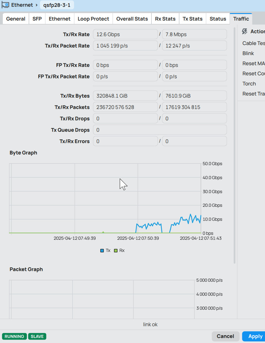

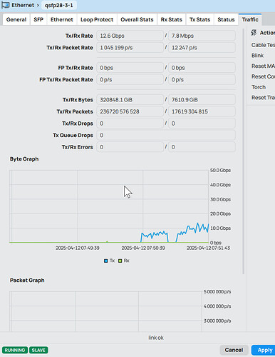

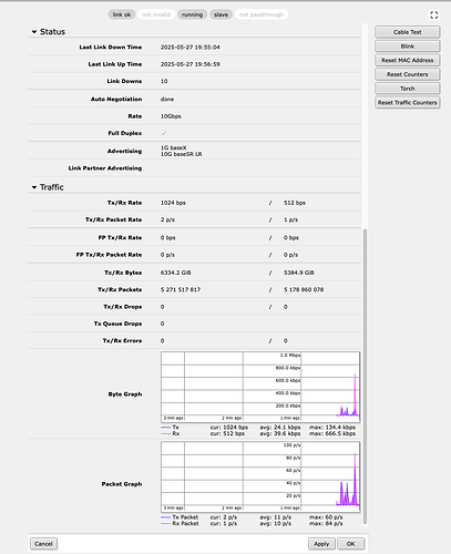

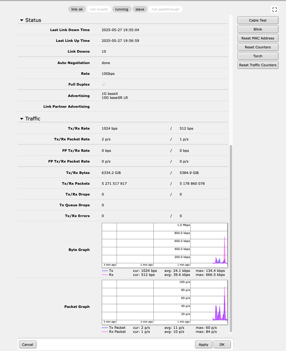

Given that you run a Mikrotik, do you mind doing a test bandwidth transfer (with the 100G card) and meanwhile grabbing the equivalent of the Status and Traffic panels from the Mikrotik UI, showing the stats related to the interface connected to your TrueNAS server?
Something similar to this
Here.
You can see on the Traffic capture first a run with one PC making large file copies from a Gen 5 NVME SSD, and then what happens when I start the same from another PC USING A Gen 4.
Te first PC was peaking at 600 Mbs, and with the second, it went up 1200, so 10G speed. I don’t have another PC to try a third stream. If I use several tasks by PC, the total does not change.
