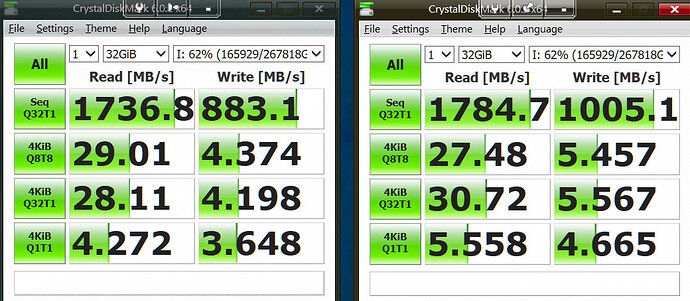

Here are the results, similar on both PCs:
Raw internal RAID write speed it 3800MBs, so the network is still limiting, but much less than before. It’s already respectable.

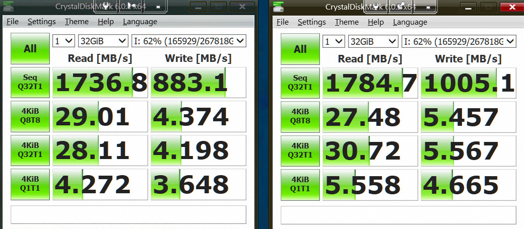

Here is what I get with 2 PCs running the same test at the same time:
That’s an impressive 3.5G read speed and 1.8G write speed.

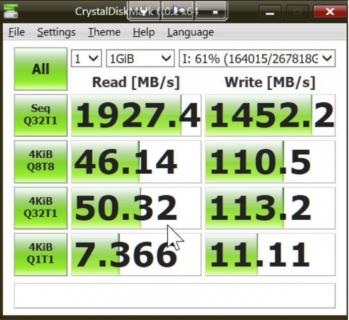

I’ll disable sync writes, and see how much it changes muxing time for example.
Edit: disabling sync boosts sequential read by 12% and leaves sequential write unchanged (with CrystalDiskMark). I would have guessed the opposite!
