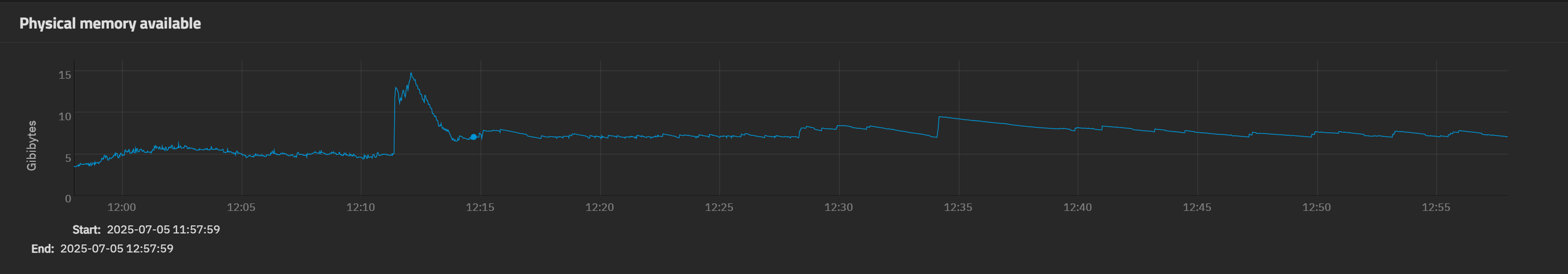

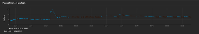

Thats the RAM-Usage over time.
Uptime is about 18h atm

That looks okay, no warning signs at least.
