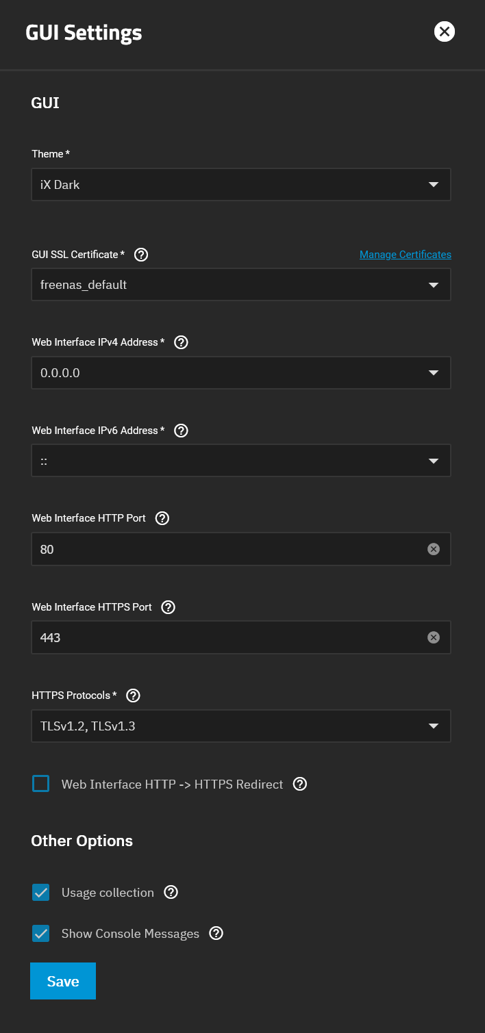

As far as the drop-outs in being able to reach your NAS, do you see anything in the console massages? If you don’t have those enabled, you can go to settings > General > GUI> Show Console Messages > Checkmark
It might give a hint on what is causing the drop-outs. Otherwise if your NAS uptime is stable & it isn’t rebooting randomly & it is only your connection to the NAS on your network that is failing… maybe it is your network card.
