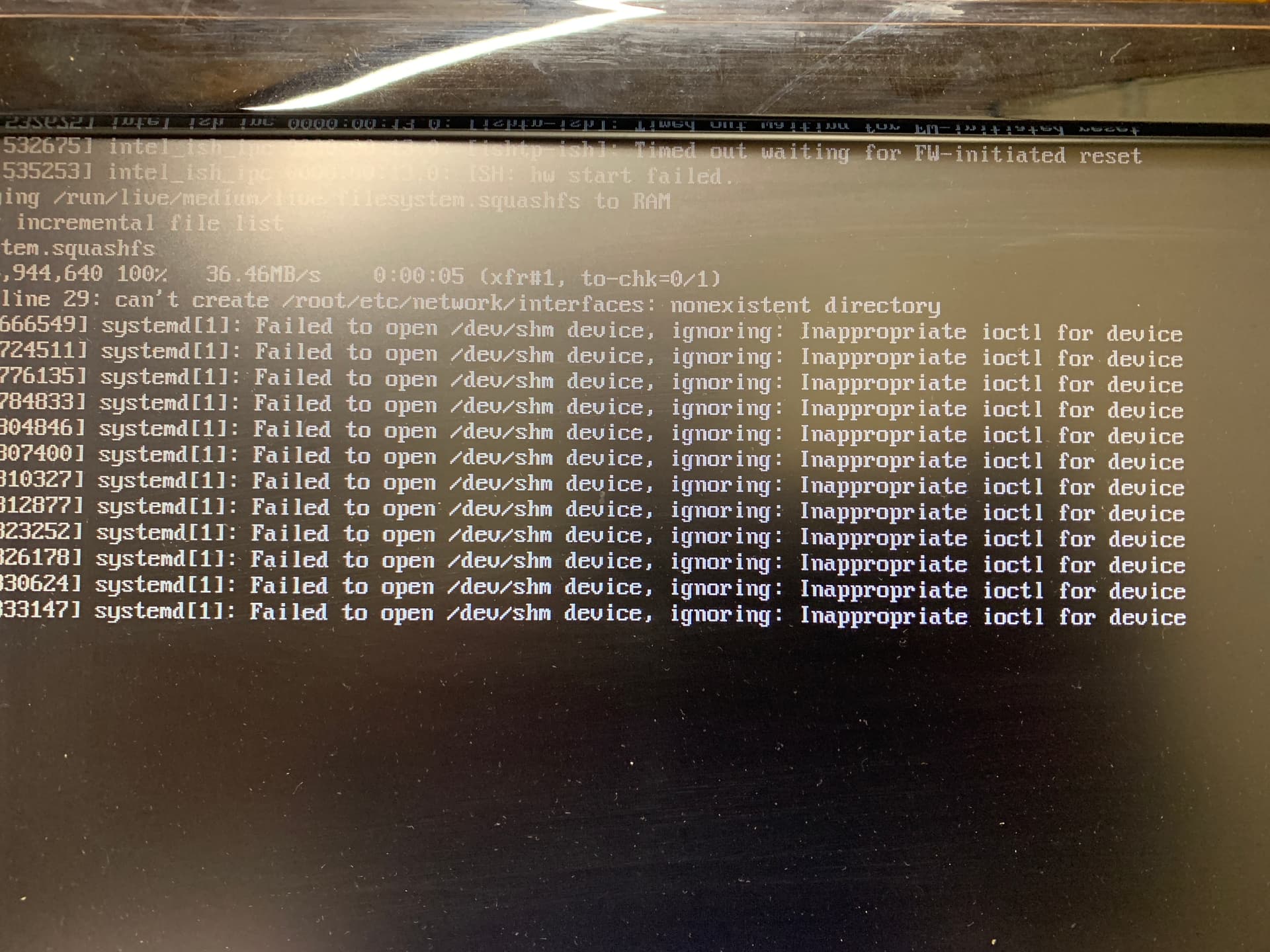

I have just booted the SuperMicro Server using the USB I flashed with TrueNAS Scale iso, checkd the boot priority and it was set to and it has booted into Kubuntu?
Reflashed the USB using the same iso and this time I used F11 and selected USB.
This time it booted into TrueNAS Scale, however there appeared to be a lot of errors before presenting the TruesNAS 24.10.1 Console Setup (see attached image).
One in the console I selected Install and noticed that the SSD drive that I am using has Kubuntu on it :slight_smile: so the boot order was wrong earlier :slight_smile:
However there still appears to be a problem.

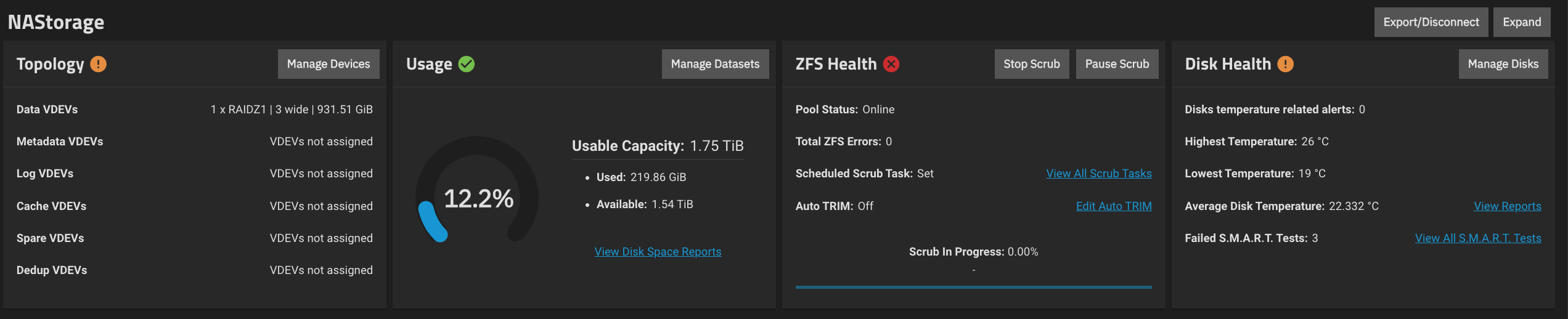

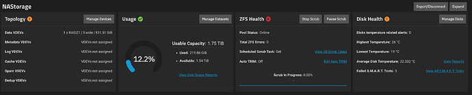

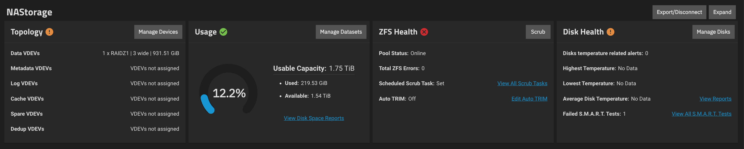

I managed to install TrueNAS and the IP address is the same as before. So I managed to get into the TrueNAS web interface. The guide I am following is either out of date or the problems I am having is causing me to see a different screen.

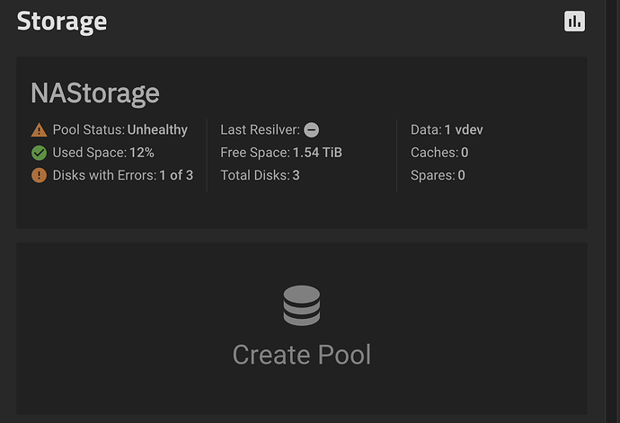

I am trying to import my pool and if I click on Storage, I don’t see any discs only the option to create or import a pool? So I selected import and after a while the name of my old storage came up NAS_Storage. However it just sits at pool.import_pool.

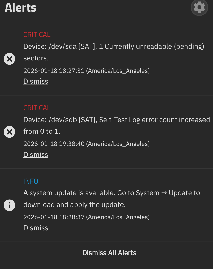

I am guessing you should post back the results from the following commands so we get an idea of the current status of your system and the pool import. Please post back using Preformatted Text mode (</>) or Ctrl+e on the toolbar. The ‘import’ command shouldn’t do anything but just report info. It might be a good idea to check on the health of your HDs. The last command and post each drive back in it’s own Preformattted text window.
sudo zpool status -v
sudo zpool import
for disk in /dev/sd?; do; sudo smartctl -x $disk; done

Just move backed into the house and reconnected and noticed these messages:
And I have just tried importing the pool NAS_Storage again and after a short while this page appeared:
What do I do now?
Yes, your drive with the serial number WD-WMC1U6178752 is showing errors:
It also failed its recent (and only) short SMART test.
You are missing the Toshiba from the ‘smartctrl’ data. I only see the two WD Green. One has 5 reallocated_sector_ct. Your dashboard is showing a failed SMART test. I don’t know if that is your boot drive or the HD with the sectors.
It looks like you have your pool back, right now. Do you have a backup of all your data from that pool?
Get a backup of your system configuration file in case the boot-pool dies and we need to install again.
It would be good to run SMART Long tests on all your drives and post back the results. Your alerts show two critical alerts on different drives.
As a side note, I don’t know if I would trust WD Green drives for NAS use. Consumer type drives have different firmware etc and sometime behave in unexpected ways to the NAS software. You can search interet for articles explaining why to use NAS type drives.
“NAS hard drives are generally recommended, as their firmware is tuned for server workloads,
with desktop-oriented features disabled or set to more appropriate timings” Snip-it from the TrueNAS hardware guide 2021 R2 PDF.

I have run the SMART test, where can I download the results?
This should bring up the test results for all your drives by using the CLI.
If you want to do disk by disk, just do the sudo smartctl -x /dev/sdX and fix the drive name sdX for each drive.
Here’s the results:

And here’s the zpool status:
truenas_admin@truenas[~]$ sudo zpool status
  pool: NAStorage
 state: ONLINE
status: One or more devices has experienced an unrecoverable error.  An
        attempt was made to correct the error.  Applications are unaffected.
   see: https://openzfs.github.io/openzfs-docs/msg/ZFS-8000-9P
config:
        NAME                                      STATE     READ WRITE CKSUM
        NAStorage                                 ONLINE       0     0     0
          raidz1-0                                ONLINE       0     0     0
            acf6f3ee-1b35-4937-84ae-ddde6ae32d29  ONLINE       0     0     0
            91982a55-003d-429a-b826-6c69b6b626fe  ONLINE       0     0     0
            530714ac-9045-4e49-9960-89440b4cfb87  ONLINE       9     0     0
errors: No known data errors
  pool: boot-pool
 state: ONLINE
config:
          sda3      ONLINE       0     0     0
And this is showing on the main GUI
And this:
I am in the process of running a scrub, but what other steps should I take now?
This drive may need to be replaced. You got another Reallocated_Sector_Ct. I would keep a recent copy of your system configuration in case the boot drive dies. I didn’t see a SMART test for that but you did show a screenshot of the Alert with unreadable as SDA above.
You aren’t using much space so I would just make sure you have another copy of the data somewhere. You probably could clear the errors and just watch the system.
